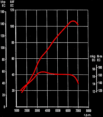

Characteristic engine curves (EC) |

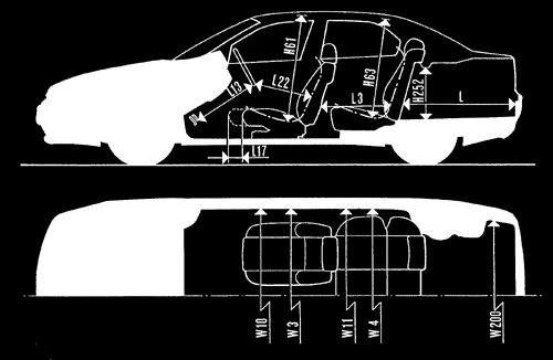

INTERNAL DIMENSIONS |

Luggage compartment measurements: |
H252 |
Height |
415 mm |
Official fuel consumption (mpg) |
W200 |
Max. width |
1,330 mm |
ECE |
24.8 |
L213 |
Length |
930 mm |
EUDC |
44.1 |
V210 |
Volume |
378 dm³ |
ECE + EUDC |
34.4 |

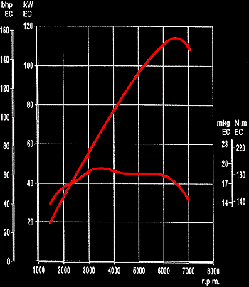

PERFORMANCE |
Top speed (mph) |
134 |
W3 |
Front waistline width |
1,398 mm |
Speed with engine at 1,000 rpm in 5th gear |
20.9 |
W4 |
Rear waistline width |
1,390 mm |
W10 |
Front elbow-room |
1,414 mm |
W11 |
Rear elbow-room |
1,458 mm |
H61 |
Front head-room |
962 mm |
H63 |
Rear head-room |
945 mm |
Acceleration from standing start |
L13 |
Centre brake - lower edge of steering wheel |
605 mm |
(1 adult + 30 kg) (secs) |
L17 |
Seat travel |
220 mm |
- 0-62 mph |
8.6 |
- 0 to 1000 m |
29.6 |
H252 |
Height |
415 mm |
W200 |
Max. width |
1,330 mm |
ECE |
24.1 |
L213 |
Length |
930 mm |
EUDC |
42.8 |
V210 |
Volume |
378 dm³ |
ECE + EUDC |
33.2 |
CO2 emissions |
202 g/km |

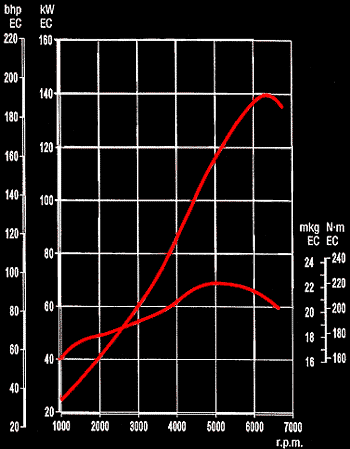

Click on image for full size enlargement |
